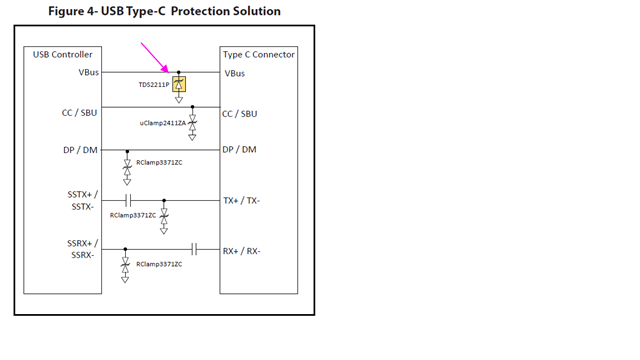

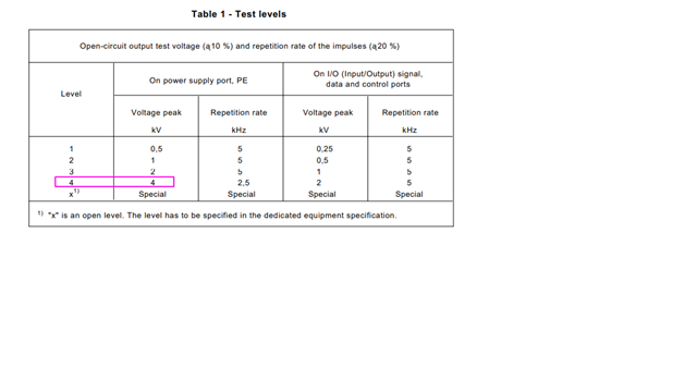

Please help to suggest which IC is the protection for 5V VBUS? Customers need LEVEL 4 4KV IEC61000-4-4
Hi Gareth,
The TVS2200 is a good replacement here with very similar specs. It has a Level 4 IEC61000-4-4 rating.
