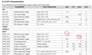

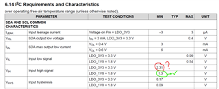

    [1] please see the tables below from the datasheet section 6.13 and 6.14 which I found it confusing and why I asked the question here. If I tied SCL and SDA pullups to LDO_1V8 instead of LDO_3V3 to make it compatible with our host controller, what would be the logic-high voltage when both LDO_1V8 and LDO_3V3 are available in the system? There are three different values, one doesn't comply (2.31V).
    [2] So what I understand from you that connecting I2C2 slave port to our host controller would be sufficient to control TPS65987DDJ and update the content of the SPI flash connected to the PD. Is that right?
  • Hi Mehmet,
    [1] All the devices are set to the LDO1V8 thresholds which work for both pull-up voltages. Disregard the LDO_3V3 thresholds.
    [2] Yes
