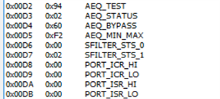

As of now the 960 is showing that it is receiving image data (1280x800) in the information tab of the ALP, however the SoM is not able to see the video data when connecting to its CSI camera port. From previous forum posts it seemed that once people had the image data shown in the information tab, they were able to easily transmit this data through the CSI TX port on the 960. This has not been the case for me, so I am looking to for a point in the right direction. Could I have some registers wrong, a bandwidth issue? This is my first time working with MIPI protocol so I feel I might be missing something. Unfortunately, I cannot post a register dump, due to company IP but any recommendations to check for would be very helpful (ex: typical registers that are misconfigured, a point to another forum, etc..)

    0x02-0x06, 0x0C, 0x1F-0x24, 0x32-0x37, 0x40-0x49, 0x4C-0x58, 0x6D, 0x70-0x76, 0x7A-0x7C, 0xB9, 0xD2-0xDB

    I am not sure what is meant by the right Rx port? There are 4 Rx ports on the 960, but here are the values of the requested registers.
    0x000C 0x0F RX_PORT_CTL
    0x006D 0x7C PORT_CONFIG
    0x00B9 0x33 LINK_ERROR_COUNT

    Almost all your register values are indicating normal running system. But there are some comments:
    reg 0x21=0x04 which means Basic Synch forwarding is enabled. Please disable that since you just have a single Rx Port active.
    reg 0x33=0x23 indicates that you are using only 2x CSI-2 lanes at a speed of 800Mbps/lane
    The incoming data bandwidth is 1.54Gbps but your output with this configuration can only support 1.3Gbps. Hence, you must increase the number of lanes to 3 lanes at least or increase the speed to 1.2Gbps/lane
