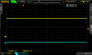

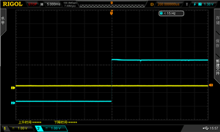

when the usb 2.0 device is inserted,D+/D- signals were captured on the upstream of tusb8020,downstream were captured also.
upstream as follow(ch1:D+  ch2: D-),have none change on the D+/D- line:
downstream as follow (ch1:D+  ch2: D-):
any suggestions? thanks.
