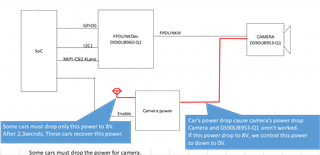

Dear TI expert,
We are using DS90UB960-Q1 and DS90UB953-Q1.Our sysytem is in below.
Some cars must drop the power for camera.
Then Camera and DS90UB953-Q1 aren't worked.DSDS90UB960-Q1 contines to be worked.
After 2,3seconds, recover the power for camera, but The video data in Soc is no data.
Maybe SoC can't get video data from DS90UB960-Q1.
Camera Vendor said, the power of camera needs to down to 0V once, and power on again.

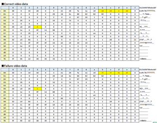

So we did it, the video data came back in SoC , but capture image is incorrect. ( Please refer Failure video data in below)
I'd checked the DS90UB960-Q1 register,   results in below.
I'd checked the DS90UB953-Q1 register,   results in below.
Could you please tell us how to recover in DS90UB960-Q1  from the phenomenon?

  • Does the failure case ever occur before the 953 is powered down? If it only occurs after the 953 has been powered down, does the failure occur immediately after the 953 begins to transmit data again? I can see in the registers that gpio2 is being used and frame sync has been enabled. What function is gpio2 performing and are you using frame sync? Is the SOC aggregating multiple video streams or is there only one camera in your system? In the failure video data the upper portion looks like it could be from a different frame, is it possible that the SOC could be trying to combine the incomplete frame from when the 953 powered down with the new frame after power is restored?

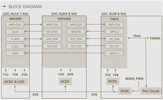

    I am using the following cameras, so gpio2 should be used as ISP reset signal.
     It's not immediately clear if the frame sync signal is used, but judging from the block diagram, I'm guessing that GPIO0 is the one.
    https://www.leopardimaging.com/wp-content/uploads/LI-IMX390-GW5400-FPDLINKIII-xxxH_Datasheet.pdf
    ⇒I am using only one camera in my system.
    As shown in the figure below, the upper part also changes in chronological order, so I think the possibility is low.
  • Looking at the registers it seems like frame sync is enabled, but it is not currently programed to be sent through gpio0. Although if there is only one camera in the system, frame sync is probably not necessary because there are no other frames to synchronize with. Did you need, or was it planned, to use frame sync in this system? The first block diagram includes gpio0 on the 960 being used to communicate with the SOC, is this pin related to frame sync as well or is it related to another function?
    In the fail case gpio2 is showing as high but the correct case gpio2 is low. So it seems that the failure case may have some correlation to an event occurring that would warrant an ISP reset, which could likely be the 953/camera being powered down. Is it correct that the gpio2 signal is being generated internally from the 953 and is not passed over from the 960?
