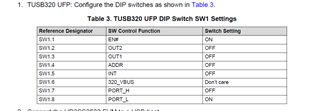

I need help with my TUSB320EVM Board. I have trouble to set up high current in UFP Mode. I get only the "standard" 0.5A and 5V out of Vbus.
Here are some more details on what I did on this board: I´ve set dips for UFP Mode (Datasheet Page 5 of TUSB320EVM). Pluged in USB-C cable (J7). Pluged in a "modified" µUSB cable (with only + and - on the other side) into J6. The + and - of the µUSB cable went into a battery charging IC (BQ25792), that can meassure voltage and current. Here I´ve meassured only 0.5A independently of the USB-C connection. I´ve used a couple of usb-c sources e.g. laptop power supply with 65W output.
I think i need to write into CURRENT_MODE_DETECT register, to set current to high, right? Is there a ti software/application for that?
