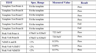

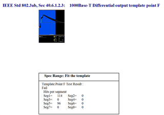

Hi expert
The flowing file is the Eye Diagram for DP83867 chip 1000BASE-T Template (Test Mode 1) .
Point F and Point H failed
can you give me some tips for it to fix it . thanks

Hi Zhang,
1000BASE-T is a tight spec. The differential output failures can be based on the board schematic/ layout and the components used also can play a role to cause this failure.
The major thing to verify is if there is any throughput loss, did you notice anything in this application?
Rahul
