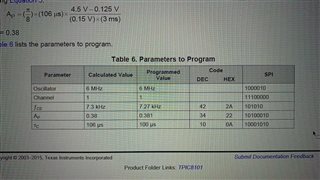

After configuring the knock chip according to the datasheet, the out pin of the chip has a integral signal output without engaging the knock signal.
 figure 1
 figure 2
Follow the example configuration in Figure 1.Figure 2 shows the test signal, where purple is the window signal, blue is the TPIC8101 out pin signal, and green is the input knock signal.
