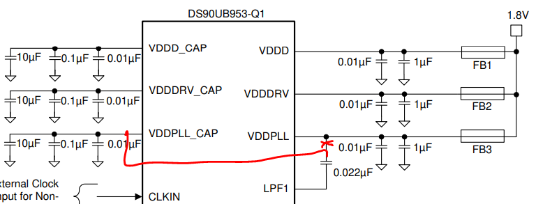

DS90UB953-Q1: LPF1 Cap Connected to VDDPLL_CAP
Part Number: DS90UB953-Q1
Hi team,
Customer has accidently connect LPF1 cap to VDDPLL_CAP pin instead of VDDPLL pin - it is late to change design and hard to re-wire. Design will be corrected in the next phase but key question is will below connection still work functionally on the existing board?
  • Hello PY,
    This LFP pin during operation will have a range of 0-1.8V depending on voltage and temp change. If this is not maintained, which will be the case on your design, you may see stability problem for either FPD-Link output or CSI-2 inputs. It is not easy to exactly predict what is going to happen since this is not a valid use case and was not tested in this form.
