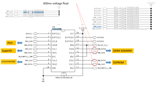

    All pins are pulled up, but only SCL3, SDA3, SCL4, and SDA4 are powered separately and have a floating voltage of about 0.6V
    Please tell me about my question as well.
    What do you mean by this statement? Do you have a schematic to help explain what you are describing here?

    Do you have a schematic we can review?
    -Bobby
  • Hi Bobby,
    Pulses are sent to SCL and SDA of Bus0 that are latched up.
    A schematic is attached.
    Sincerely.
    Ryu

    Have you had a chance to try Bobby's suggestion on bringing VCC close to GND before conducting a POR? It seems that the VCC level rests at about 500mV before being powered up. Can we try powering from GND instead by implementing a bleeder resistor of about ~20kohm?
    Schematic shows PCA device and corresponding pull-up resistors on both sides of the device. Are there any other I2C devices present on the I2C BUS0?

    This symptom subsided when I suppressed the voltage float (common power supply for device power supply and BUS3,4).
    Why does the latch-up occur when there is voltage floating?
    Also, there are no other I2C devices connected to BUS0.
    Sincerely.
    Ryu
  • Hi Ryu,
    Floating voltage puts the PoR circuitry in an unknown state, causing the device to behave improperly. Powering from a non-GND condition is not recommended for this device. We recommend removing the voltage float for your system. Implementation of bleeder resistor of ~20kohm is also recommended.
