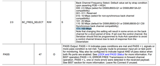

Hi Team,
As title, we found BC = 100Mbps, PASS pin can't work, but BC = 50Mbps/25Mbps can work. Do we have the limitation?
Roy
Hi Team,
Roy
Hello Roy,
our devices do not support the 100Mbps BC mode. It is shown on the register map just as a place holder. We may need to remove this from the datasheet to avoid confusion.
