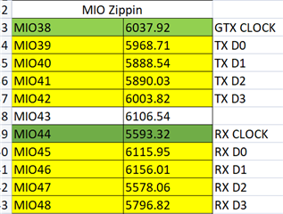

We are using TI,DP83867IRRGZ phy IC which is interfaced to gem1 pins of zynq ultrascale+ SoC and phy mode is phy mode configured in RGMII interface. One observation is that for the GTX clock (Pin 29) we are getting only 25Mhz instead of 125MHZ and RX clock (Pin 32) is 25Mhz at that that it is working on 100mbps.
While we tried to configure it for 1000Mbps at that time, the GTX clock comes 125 Mhz but the RX clock is 2.5Mhz only. From the board when we check the carrier status on the board it is showing as 0, meaning there is no link established with the device. Please find the ethtool logs of the ethernet interface. xilinx-k26-som-20221:~$ cat /sys/class/net/eth0/carrier 0 please let us know if you require more information from our side and also let us know how we can debug the 1000mbps issue further

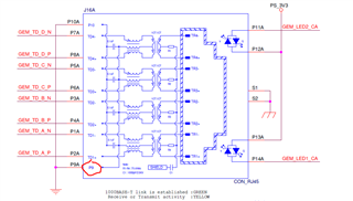

Here I attached our DP83867IRRGZ schematic for the refence.
Waiting for your sonnets response.
sch_501-1-02258_a2.pdf
