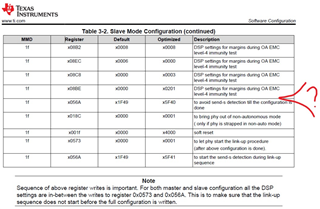

Hi Expert,
When should we disable the Clkout?(Reg0x453=0x6 and Reg 0x452=0x600)
Hi Expert,
Hi Imelda,
You can place these registers at the end of the initialization sequence for Master and Slave (i.e., after 0x056A = 0x5F41). It should be okay placing these registers elsewhere too, there will not be change in performance.
Gokul.
