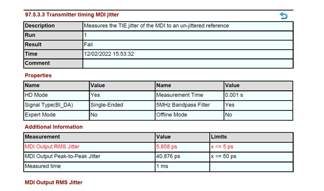

The output RMS jitter of the Gigabit Ethernet MDI is out of range, about 59 ps.

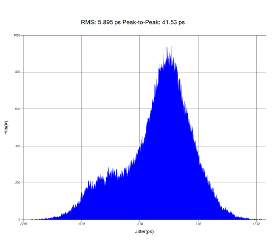

Hi Yin,
Higher jitter can be caused due to many of the following reasons like setup, probe and scope inaccuracy, coupling of some other signals to MDI, supply and ground noise etc.
I see that measured value is very marginally failing which means we are close, but need to look into what is making this bad.
Can you please measure TX_TCLK during this test mode? This should be available on CLKOUT by default in testmode2. Else, I can let you know the register configuration.
Can you also measure the jitter CLKOUT_25MHz (25MHz clock) after forcing the device into RESET (i.e., holding RESET_N low always)? This should give us an indication if the problem is inherently with crystal oscillator jitter.
Gokul.
