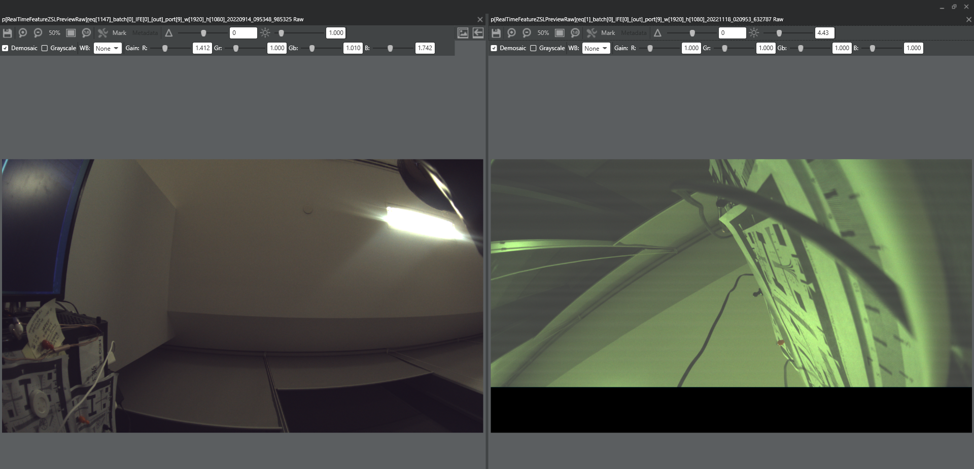

Hi ,
I am debuging imx307with 954 954.
The raw dumped by mipi interface is okay with 1920*1080 raw12 format.
While connecting with 953 954 the size received become 1920*1080*raw10/8.
So we doubt the mipi packet has been modified by 953. we what to find a way to solve this problem.
below is the register .

  • we using replicate mode. 4 camera mipi data lane connected with 953 into 954  rx0 vc0, out into two mipi data lanes received by qualcomm ISP.
    when normal ,we used  4 camera mipi data lane connected  to qualcomm ISP.
  • there is no problem with raw10.
  • when start stream, msleep 5000 and dump the register

  • Hello Yazhuan,
    Our SER and DES do not change or modify any data type or content. Any thing comes in will be transferred as is!
    I have checked your Register dump from SER. I can see that the received data type from image sensor is not RAW10 or RAW12. The received data is Embedded 8-bit non image data. See register 0x61 = 0x12. For RAW10 this register will read the value 0x2B and for RAW12 the value 0x2C.
    Hence, please double check the configuration of your image sensor!
  • Hi Jaradat,
    Qualcomm isp will check the mipi packect. There is no problem with raw12 when sensor connected directly with sensor.
  • I checked both raw10 and raw12. All the registers 0x61 is 0x12.
    Neither the document register description is not correct nor 953changed this.
  • I checked the mipi long packet header. SOC isp received DT is raw12 type.
    besides,I ,modified the mipi clock rate. It doesnot work anyway.
  • As I said, our SER and DES do not change or modify any data type or content. Anything comes in will be transferred as is!
    Please double check the Imager configuration and make sure it is configured to output RAW12.
  • I modified one register of 954 and the raw12 streams output becomes normal.
  • Hi Yazhuan,
    Thanks for your feedback. Can you tell me which register did you modify, and what did you change?
