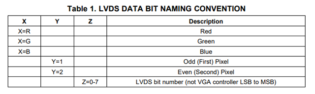

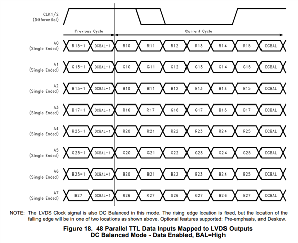

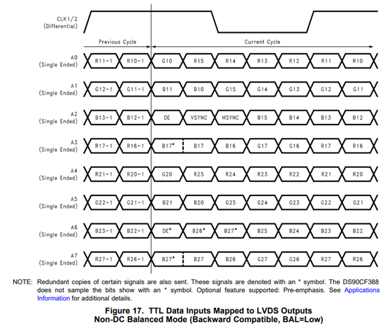

Good Afternoon,
I am designing a Hdmi to LVDS bridge and am having issues understanding how the connections from DS90C387VJDX/NOPB LVDS outputs should be connected to my TFT (i have attached for reference).
I have 8 differential data outputs (A0 to A7) and 2 differential Clock outputs (which are identical so can be interchanged).
My TFT requires that i provide 4 differential channels to provide the Odd data (OLVx), and 4 differential channels to provide the Even data (ELVx).
Which of the outputs from DS90C387VJDX/NOPB differential channels provide the odd data (that i can connect to OLV0 to OLV3) and which do i conect to the even (ELV0 to ELV3).
I appreciate any clarity on the matter as pg18 and pg19 are not clear.
www.ti.com/.../ds90c387.pdf
How am i to deduce if the TFT should be driven in DC-Balanced or Non-DC-Balanced mode?
I have provided Voltages/Logic input into configuration pins on the IC for reference:
BAL = HIGH
DUAL = HIGH
PD = LOW
R_FDE = HIGH
R_FB = HIGH
PLLSEL = HIGH
