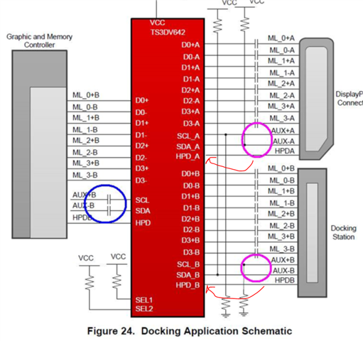

Hi Team,
I'd like to know if it's OK to move the AUX ac caps from the blue circle to the purple circles (ac coupling at the connectors instead)?
Thanks!
Roy
Roy
You can move the AC coupling capacitors from the common port to Port A or B. But the capacitors has to be placed between the TS3DV642 and the pullup and pulldown resistor as shown below.
Also when moving the capacitors to Port A or B, the TS3DV642 common mode voltage is set by the graphic controller and not by the pullup/pulldown resistor. Please make sure the graphic controller common mode voltage meets the TS3DV642 requirement.
David

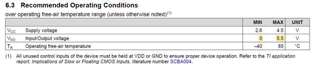

Thanks, David.
What's the common mode voltage requirement of the TS3DV642? Is it 0 ~ 5.5V?
Thanks!
Roy
