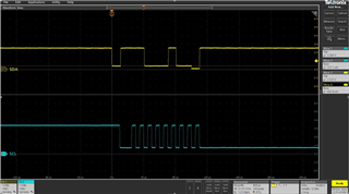

But customer meet a problem that high level of SDA_3V3 and SDA_5V0_0 always keep at 2.5V, seems as same as Vref2=Vref1+Vth=1.9+0.6=2.5.
Below picture is captured of SDA_3V3 and SCL_3V3:

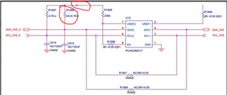

  • Is Vref2 pull up resistor tied to a 5V source?
    Why is R1887 populated but R1888 do not populate?
    -Bobby
  • The high voltage side are 3.3V and 5V, and pull-up resister tied to 3.3V and 5V souce.
    About R1888 NC of SDA_5V0_0, this is because there is internal pull-up of 5V I2C device.
  • The waveforms seem to show that SCL is 3.3V and SDA is 2.5V. Generally we see this kind of issue when a pull up resistor isn't present while there is a PCA9306 (or I2C switch) on the bus leaking current in from the higher voltage side into the lower voltage side until the voltage is Vgate-Vth.
    The other possibility is if the gate voltage is higher than expected resulting in the PCA9306 (or I2C switch) trying to regulate itself back to it's cut off region/mode by setting the source to Vg-Vth. My current guess is this is likely the issue.

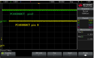

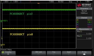

  • Attached please find the EN (pin 8) and Vref1 (pin 2) scopeshot of PCA9306 in parallel of 2V->3.3V and 2V->5V:
    Please help to check
    -Mike
  • Hi Mike,
    Bobby is out of office for the holidays and will return in early January.
    It look like the gate voltage at PCA9306s EN pin is not at the proper level. The nominal voltage at the EN and Vref2 pins will be Vref1 + 0.6V when regulated correctly. Please check the values of the 200k-ohm resistors to ensure there is one more leakage than expected from this supply path.

  • Yes, I confirmed  there are pull-up resistors on nets SDA_5V0 and SCL_5V0.
  • Mike,
    Could you possibly try populating R1888 to see if it addresses the problem?
