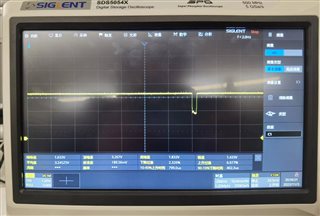

but when the DS90UB948-Q1 is powered on or in use, if the power supply of the DS90UB948-Q1 is momentarily abnormal and the power is off, the output LVDS video signal is a bit abnormal, and the display is abnormal, how can we detect the abnormal situation? The lock pin will not change and cannot be detected through this pin?

    1.I mean, after working normally, the VDD of the DS90UB948 drops to about 1.8V instantaneously due to the fluctuation of the power supply on the car and recovers after several hundred milliseconds. At this time, abnormal display may occur, and the entire system needs to be rebooted to recover.
    2.The probability is relatively small. It is difficult to capture the power waveform of the DS90UB948 when the whole machine is installed on the car.The abnormal output signal is caused by the transient power failure, which causes the LVDS differential output amplitude to slightly decrease by more than 10 mv or individual differential pairs have no data output.
    3.During operation, for example, when VDD is powered down to 1.8V and then quickly recovered to 3.3V, can we obtain the exception by monitoring the register status of 948? Could the image phenomenon in the previous post be caused by the DS90UB948's abnormal operation.
    Yes, this is very likely possible. The VDD33 has a tolerance range of 3V to 3.6V. If this voltage drops all the way down to 1.8V then this is a clear violation of the device specs which could lead to anything, from disturbing the input signal to no output on the display.
