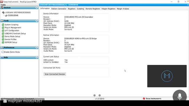

Dear expert,
Customer connect UB948 with USB2ANY. Other side is UB929.
Below "information" page shows everything seems normal.

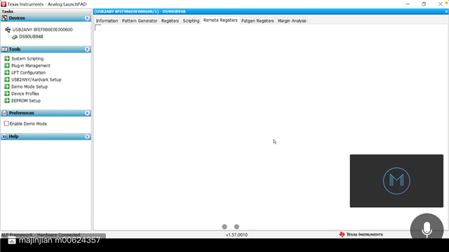

However, the 2nd pic shows "remote register" empty. I don't know why. (UB948 0x03 register I2C pass through is set.)

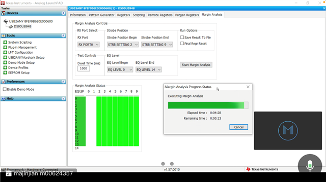

Then the 3rd margin analysis shows all green. It is abnormal.
Could you comment why?

  • Hi Ryan,
    A few questions:
    • Is this using EVMs or customer system?
    • Can the customer access the remote 948 registers when connected to the 929?
    • Can the customer access remote 929 registers by writing commands to the scripting tab?
      • For example, "board.ReadI2C(0x18, 0x00)"
      • This command should return the I2C address of the 929, if there is some I2C or link issue, it may return 00
    Ben
  • Ben,
    It's customer system.
    We didn't try ALP from UB929 side yet because it need manually solder I2C signal. We will try later.
    Will try.
    In fact, we are blocked with another problem. ALP from UB948 always shows unknown device at other side(UB929). Even UB948 shows LOCK status at 0x1C register. And I2C pass through is enabled in 0x03 register. And 0x07 register can get right remote ID 0x18.
    You can check below UB948 register dump. What might cause this phenomenon?

  • Hi Ryan,
    It looks like MODE_SEL1 is set to #4 which is coax mode, 20Mbps backchannel rate. The back channel frequency must be set to 5 Mbps when paired with a DS90UB925Q-Q1, DS90UB921-Q1, DS90UB929-Q1, or DS90UB927Q-Q1. Please change the mode strap accordingly.
    Ben
  • Ben,
    Pls refer to "https://e2e.ti.com/support/interface-group/interface---internal/f/interface---internal-forum/1177673/ds90ub948-q1-coax-mode/4449288#4449288"
    I've asked this in E2E. William response:
    "UB929 can support a maximum back channel rate of 20Mbps. What you are looking at is a typo on the UB948 datasheet. The UB929 can support rates of up to 20Mbps like it says on the UB929 datasheet. "
    And in fact, we also tried back channel rate of 5Mbps with UB929. It still report "unknown device".
  • Hi Ryan,
    Oh yes, I remember William mentioning this typo now, my bad. Has the customer been able to read remote registers manually via the scripting tab?
    Ben
