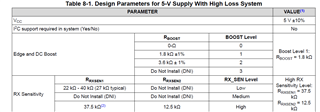

Could you tell us which combination has max driving strength?
The choice: BOOST is Level 3 and RX_SEN Level is High?
if any suggestion, Please advise me.

Hi Lawrence,
Yes, that combination should have the highest driving strength possible.
