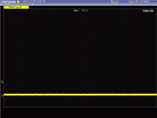

GPIO4 and GPIO5 voltage have shown "low" in waveform. the address of 0x0F,0x10~16,0xBE was shown default setting GPIO4-5.

    How is the customer setting up GPIO0-3 if you are indicating that 0x0F,0x10~16,0xBE are default? Can we just get a register dump of the GPIO to see what they are being configured?
    Also, can you show us the waveforms on GPIO 4 and 5? How many samples did the customer identify?

    Register 0x0E only reports the status of the GPIOs if they are configured as inputs. In your config based on 0x0F, only GPIO1 is configured as an input and all the other GPIO are configured as outputs. SO you should not use 0x0E to reliably read back the status of GPIO0 or GPIO2-6
