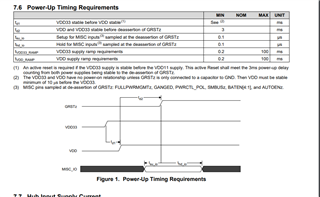

    How do you control the GRST pin? Do you have a 1uF pulldown capacitor on it?
    Please make sure the TUSB4041I power-up sequence is met and there is a valid 24MHz clock going into the hub.
    David

  • Vivek
    Please see section 7.7 for the power up sequence. Is it possible to switch from MCU driving the GRST to having a 1uF capacitor on it?
    Can you also make sure the HUB_VBUS voltage is around 500mV?
    David

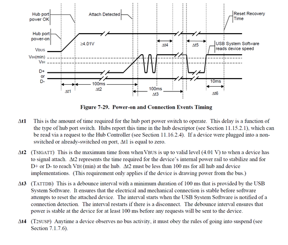

  • Vivek
    Did you see a valid 24MHz clock from the oscillator?
    You can measure the VBUS, D+, and D-, and you should see the below waveform,
    David

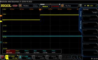

  • Hello David,
    Thanks for the advice. We have followed your timing diagram and along with that, we have captured the signals for the GRSTZ and 1V1 of the USB hub.
    the yellow channel is GRSTZ pin state and the blue channel is 1V1 power rail. As given in the power-up sequence of the USB hub, we can conclude that the GRSTZ pin is high after 1V1 is given to the USB hub, but the slope of the GRSTZ pin, going from low to high is very high, as compared to the timing diagram in the datasheet of the USB hub.
    Please share your thoughts on this issue. If possible, we can have a 1-to-1 video meeting, and we can solve the issue if it is comfortable for you.
