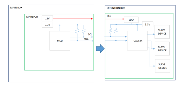

Will the HOT SWAP function work effectively in a circuit with the following configuration?

    Chris
  • The TCA9544A is a slave device, so its I²C pins are high impedance until the master accesses it.
    The image does not show any other I²C devices on the main PCB, so there is no danger that the plug-in action could disturb other I²C communication.
    When the extension LDO has not yet started up, a current might flow from the main 3.3 V through the pull-up resistors into the externsion 3.3 V supply. As far as the TCA9544A itself is concerned, this is no problem.
