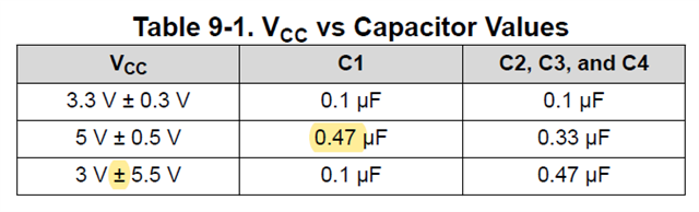

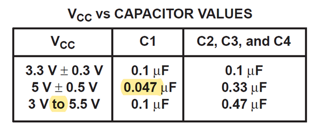

Hi support team.
We received an inquiry from our customer as follow.
When the datasheet is changed from Rev.C to Rev.D,
The description of operating voltage and capacitance C1 has changed.
Rev.C
Rev.D
Why was it changed?
Or is it a typo?
Higa
  • Higa,
    Thanks for posting. It looks like this might have been a typo that arose when updating the data sheet to the newest version. The process is not automated, so it looks like these adjustments to the table were not intentional.
    I have checked and confirmed that the original version ("Rev.C" above) of the table is correct, and I've started the process to get this data sheet updated back to the first version.
