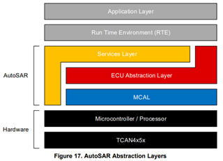

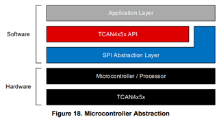

    The CAN "demo starter code API" is low-level ANSI-C typically used in microprocessor firmware and is typically at the lowest  level calling the SPI driver communicating with the TCAN4550 device on a physical layer.  This level of code abstracts the lowest level SPI register read/write transactions into higher level functions that can be called by an even higher application layer of code.  Porting this code to different microprocessors would generally only require changes to the SPI Abstraction Layer to become compatible with the processor's low level SPI driver and unique hardware requirements.
    The "AutoSAR abstraction layer" is an abstracted layer of code that has specific functions defined by AutoSAR.  This code is not built on any specific hardware platform or processor which allows it to be ported to different platforms.
    The Microcontroller Abstraction Layouer (MCAL) provides standardized function calls to peripherals of a microcontroller such as the IOs, bus ports (SPI or I2C), or even memory.  By abstracting these peripherals to common function calls, it makes it possible to simply swap MCAL drives for a different processor when migrating, but all the code above should behave the same with very little to no modifications.  These MCAL drives are processsor/vendor specific since they deal with the specific code required to perform a function.
    The ECU Abstraction Layer provides a common set of functions that an electronic control unit (ECU) would use such as CAN communication or GPIOs for sensing buttons or controlling lights.  These modules are designed to be processor independent and call on the MCAL layer to handle whatever functions are required.  In the case of the TCAN45xx, the MCAL driver for SPI is used to communicate to the TCAN45xx.
    The Services Layer provides background services to the application such as network services and bus communication services.  An example for the TCAN45xx is that a beacon bus communication may be desired (a periodic bus ping to check the status of devices on the bus) and this service communicates to the TCAN45xx ECU abstraction driver in order to actually send and receive the CAN messages.
    Texas Instruments provides the necessary ECU abstraction layer driver source code necessary to integrate the TCAN45xx into an AutoSAR environment.  However, the MCAL driver layer is vendor specific and should come from the processor vendor, or other software developer.
    If you notice that both the demo starter code API and AutoSAR ECU abstraction layer code sit at a lower level than the Run Time Environment (RTE/OS) and Application Layers, they should be able to be used by a developer to support either a Windows or Linux OS.  The code provided by TI is however at much lower level than the Application Layer, therefore, it will not be incorporated into a application designed for the type of OS used and also modified to work with the specific processor communicating with the TCAN4550 through SPI at the hardware level.
