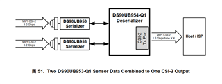

    Now, I would like to enquire two new questions for our system.
    Question 1:
    How to configure the registers for combining the data from both sensors to one csi-2 output at 954 ?
    the block diagram of our system as below (8.3  System Examples, figure 51):

    Question 2:
    the register 0x72[1:0] at 954, how do I understand 0x72[0] and 0x72[1] bit, what means of each of bits?

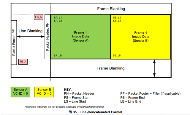

    Now, I want to combine both sensor's frame and output to CSI-2 Port 0 in 2 data lanes and 1 clock lane,  but ISP's MIPI CSI have't received proper MIPI signals.   I configured the Internal FrameSync , VC-ID mapping and  Line-Concatenate Forwarding(as below the diagram ) features, and my codes refer to 954 datasheet 7.4.28.6.1 example codes.
    as per datasheet of 954,I rewrite the registers initlialize sequeue. as follows:

    {U954,0x18,0x01}, // FS_CTL,Enable internal Gen Fsync
    {U954,0x33,0x23}, // CSI EN & Cont Clock Enable, 2 lane
    {U954,0x20,0x00}, // forwarding all RX to CSI0
    {U954,0x21,0x0c}, // Synchronous forwarding with line concatenation.

    Thank you very much for your repsponse. I would like to equire two questions:
    question1:
    I have't get the image after merged for both sensors when using above initialization sequeue. it seems that the rx1 port have't recieved frame sync signal. I refer to the codes of sections of datasheet's 7.4.27.2.1.
    below is the update initialization sequeue:

    I double checked the datasheet of sensors again.  updated both sensor's  csi lane count to 2(datarate: 445.5Mbps/Lane, 1920*1080@30fps),  953 : 4 lane and 954: 2 lane(800Mbps/Lane, output size: 3840*1080)

  • Hello Hamzeh,
    Is there any feedback? I was able to measure frame sync signals from gpio2 on both 953s, but the images did not combined on 954,why?
  • Hello Willywan,
    If you want to combine both images on the 954, you should use one of the synchronized Forwarding modes, such as Basic Synchronized forwarding, Line-Interleave forwarding or Line-Concatenated forwarding. Please refer to datasheet section "7.4.28.3 Synchronized Forwarding"
  • Hello Hamzeh,
    I refer to datasheet section 7.4.28.3, I used Line-Concatenated forwarding mode, but I was able to saw the images from RX0 on 954, I can’t saw the any images from RX1, the 0x73~0x76 haved image data from RX1,please check my register’s settings whether is all correct. Thanks!
    Willywan.

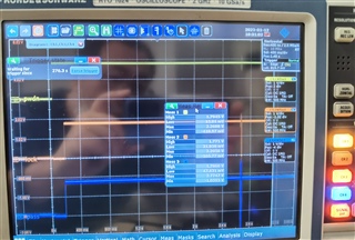

  • Dear  Hemzeh:
    I'm Ricky in charge of hardware. I have two questions to answer. Thank you
    Question 1: When the chip is started, the LOCK signal is unstable. The waveform is as follows. Is it normal?
    Question 2: Measure CSI eye map, DATA LANE| Δ VOD | has reached 20mV, exceeding 14mV of Spec, can the software be adjusted?
  • Hello Willywan,
    No, it is not normal to lose LOCK several seconds after initial LOCK. This may indicate a marginality in the link quality between SER/DES, or there could be another type of systematic event (power supply glitch, cable disconnect, etc.) causing this
    This is not something adjustable by registers. Can you share the report that you are referencing here? We have validated that 954 can pass the MIPI DPHY CTS without any failures, so I would suspect that this is either due to a misconfiguration, an error in the test methodology, or a PCB routing issue
    Casey
