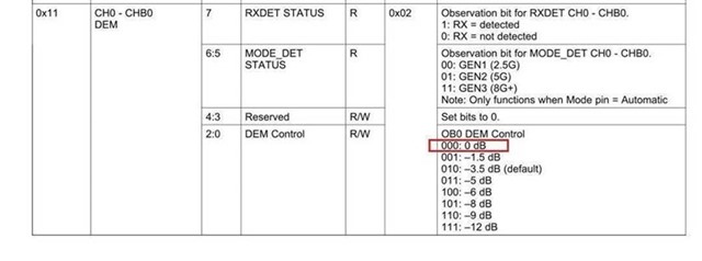

Hi Team,
Customer would like to design DS125BR800A.
Would you please help review  questions and provide your comments?
 Questions:
1. Is HW mode” with-out De-emphasis” same as SMBUS DEM:0dB?

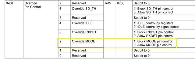

2. If allow MODE pin control in SMBUS mode, will that mode pin still the function to impact SMBUS setting?
3. how to set Transparent Management of Link Training Protocol for PCIe and SAS?(SMBUS Mode& PIN Mode)
4. If VDO will auto-adjust by VID voltage, what is the meaning to set VDO output?
5. For “The DS125BR800A repeater in SAS3 and GEN3 mode is designed to be transparent” is that equal to “bypass”?
so the TX-FIR (de-emphasis) is passed to the RX to support link training. would you please provide mode detail explanation for this?
Here is previously fine-tune result, many VDO setting are not the same. What is the reason to tune VDO instead of tuning EQ?

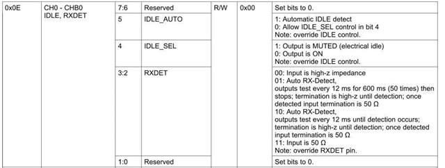

6. Is there any concern if not set in AUTO RX-DETECT?

  • Greetings,
    1). Without de-emphasis enables linear mode - allowing SAS3 or PCIe link training sequence to pass through the device.
    2). MODE pin takes priority. If MODE pin is set for 20K to GND then de-emphasis is disabled.
    3). Transparent mode is enabled by setting MODE pin through 20K to GND without de-emphasis.

    6). PCIe requires auto-detect. On the other hand, SAS3 uses 50-ohm termination(auto-detect disable).
