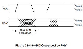

    MDIO is an input/output signal synchronized with MDC.
    Should I make equal length between MDC and MDIO signals separately from other single signals?
    Tatsuro
  • Hi Tatsuro,
    MDC/MDIO do not need to be length matched as long as they meet the timing requirements described in section 22.3.4 of the IEEE802.3 standard.
    David
