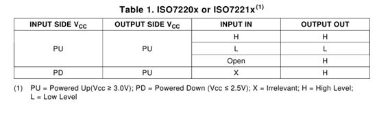

Digital Isolators (ISO7220x / ISO7221x) function table
Other Parts Discussed in Thread: ISO7240CF, ISO7421FE, ISO7420FE
Hi all...
  given the truth table of the isolator, what's the best way to invert the output signal when the input side is not powered up ?
  as I use the isolator to manage a PWM, I don't want that the external device (output side) see a PWM of 100% when my device (input side) is powered down
  is there a device with such table or do I have to invert the out signal with another IC ?
            thanks
