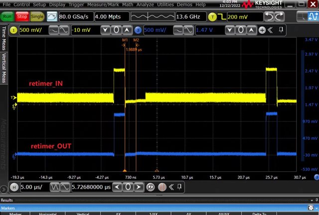

There is data input, but no HS output data. What's the reason?
Thanks!
    Are you seeing this issue on lane 0?
    DPHY440’s LP TX is expecting to connect to an unterminated LP RX.  With Lane 0 path (DA0P/N and DB0P/N) supporting bi-directional LP signaling, it is very important that DB0P/N LP TX is connected to an unterminated LP RX.  If DB0P/N LP TX is connected to a HS RX, then LP signaling will not be able to reach the LP11 levels and which will cause the DPHY440 to not enable HS data path on Lane0.
    Try following for enabling lane0 HS path:
    Enable HS path for Lane 0 only:
    Write Register 0x50 with 8’h01 //Override enable for HS TX path
    Write Register 0x51 with 8’h01 //HS TX path enabled.
    Write Register 0x61 with 8’h00  // Disable LP path.
    Write Register 0x70 with 8’h01  //Override enable for HS RX path
    Write Register 0x71 with 8’h01  // HS RX path enabled.
    Bit 0 is lane 0
