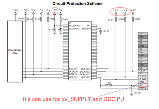

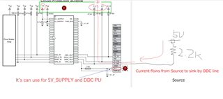

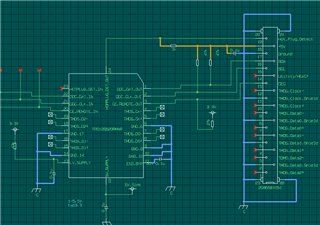

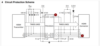

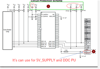

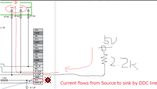

Can I use +5V supplied from HDMI connector  for  5V_SUPPLY PIN and  DDC (DCLK_OUT/DDAT_OUT PIN) PU  connection?
I have two concerns.

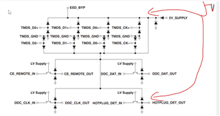

(1)Is it permissible for 5V_SUPPLY not to be supplied with 5V while VLV is supplied?
(2)Is there any problem with the HPD terminal when 5V_SUPPLY is supplied at the same time as the HDMI connector is inserted?
