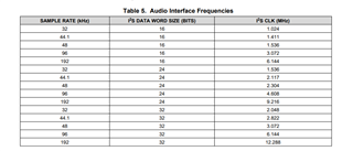

I have been working with DS90UB949-Q1 and an audio DAC PCM1753. The application is such that, the user's laptop is connected to the serializer using an HDMI connection and the display of the laptop is transferred to the serializer and then to the DeSer via LVDS. Along with the video of the user's laptop, the HDMI is capable of sending out the audio of the laptop to the Serializer and then the Serializer is sending out the HDMI audio to the audio DAC PCM1753.
As, I am able to get the audio from the laptop and from the audio DAC, but the problem is that the audio is too noisy, so I want it to remove the noise.
Here are my points and connections to the system -
1. Using the 0x55 register of the Serializer, I am enabling the bit [6] of this register to get the HDMI audio from the Serializer, then the Serializer audio output is sent to the DAC PCM1753.
2. Pins 33, 34, and 35 of the Serializer are connected to pins 3, 1, and 2 of PCM1753.
3. The PCM1753 is used on the default settings, so the SCK of PCM1753 is 27 MHz, and the sampling frequency is 44.1 kHz.
4. In the EDID of the Serializer, we have enabled the audio part and added the support for 16-bit and 24-bit along with a 44.1 kHz data rate.
5. When the audio is out from the DAC 1753, I used my windows laptop and set the audio of this device to 16-bit and 44.1 kHz, but the problem is that when I see the clock output from Serializer, I noted a few things.
     a. The BCK clock is at 2.82 MHz and the LRCK clock is at 44.1 kHz, but according to the audio standards, for 16-bit and 44.1 kHz data rate, the BCK clock should be 1.411 MHz, as stated in the below audio standards             given in Serializer datasheet.
Can you please share your thoughts that how can make the Serializer BCK clock at 1.411 kHz instead of 2.82 MHz?
Here are my questions:
1. Is there any registers to set the bit rate/ data rate of HDMI audio in Serializer?
2. Is there any registers to set the BCK clock coming from HDMI audio from Serializer?
Please solve the issue.

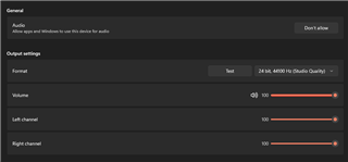

  • Hi Vivek,
    Can you share the settings from the laptop audio source? the BCLK is related to the number of audio channels set at the source.
    Prior to scheduling a meeting, please provide a dump of the serializer registers, the laptop settings and all other information that can help us prepare for the meeting.
    I have some availabilities on Thursday, 1/12. Please let me know your time zone and I will do my best to find a time that works for both of us.
    Shu
  • Thanks, Shu for the information.
    Here are my Windows 11 OS-based laptop settings for HDMI Audio devices.
    Other settings for the audio devices.
    Here is my register dump of the Serializer.

  • Hi Vivek,
    Thank you for providing the information. I looked into the issue more and may have found an explanation on the BCLK.
    By default, the HDMI block generates an audio clock of 128*fs for the audio PLL. In your case that is 128*44.1kHz = 5.6448 MHz and then that gets divided by 2 for 2 channels, so 2.8224MHz comes out of the bit clock pin.
    However, I will need to talk to the designers on how to check the word size on the 949 as it seems like it is a default of 32-bit. There may be a combination of settings that can be used to divide the I2S clock down on the local output but I would need to check with the design team to know. I hope to have more information by our meeting. I am sending you a meeting invite, hopefully the time works for you.
    Shu
