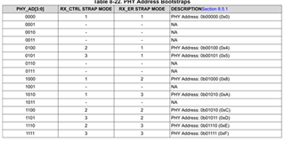

DP83TC813S-Q1: PHY AD table 8.22 :
Part Number: DP83TC813S-Q1
Team,
I have a question on the Phy add table as per the latest datasheet we have is SNLS676 – MAY 2022)
What is the meaning of the PHY_AD column as opposed to the phy address in the description ? sometimes the addresses match between the 2 sometimes not. is the table correct?
Exemple :
for  PHY_AD[3:0] = 1100, in description is indicated 0b01010 => different value
for  PHY_AD[3:0] = 1101, in description is indicated 0b01101 => same value
