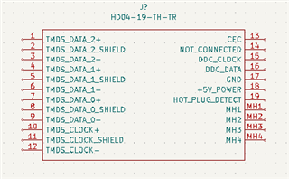

Hello, I am a bit confused about the HDMI example pinout on page 21 of the datasheet. For all HDMI type A 2.0 and 2.1 connectors which have a pinout in the datasheet I could not find the TMDS3 pin. Further I tried to find a connection between the D_x pins of the TS3DV642 and the TMDS_x pins of the HDMI connector from your EVM User's guide and came to this configuration.
(Used HDMI connector: https://www.mouser.de/ProductDetail/CUI-Devices/HD04-19-TH-TR?qs=A6eO%252BMLsxmSia1%252B4mHEhKQ%3D%3D)
D0+A   TMDS_DATA_2+
D0-A    TMDS_DATA_2-
D1+A   TMDS_DATA_1+
D1-A    TMDS_DATA_1-
D2+A   TMDS_DATA_0+
D2-A    TMDS_DATA0-
D3+A   TMDS_CLOCK+
D3-A    TMDS_CLOCK-
Can you inform me if this configuration is correct or what I should change.
As you can see TMDS_3 does not exist but there are TMDS clock pins which look very similar to the TMDS_x pins.
Greetings Martin

    This is a typo in the TS3DV642 datasheet. TMDS_3+A/-A need to be labeled as TMDS_CLOCK+/-. Also, since TS3DV642 D0, D1, D2, and D3 are the same, you can route in any lane order as long as the output lane order matches with the input lane order.
