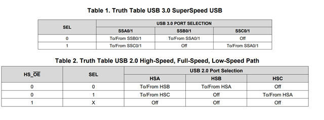

We required USB 3.0 Switch for our design.
In HD3SS6126RUAR ,enable (HS_OE) is only given for USB 2.0 .
 If
HS_OE =0
SEL=0
Then HSA to HSB will active (USB 2.0 port is  selected)
So on the same time USB 3.0 port  will select or or not?
In Host mode we want to select USB 2.0 port (USB D+/D-)
Then we want to switch into device mode in which we needed USB 3.0 port (USB SS and USB D+/D- signals)
Is this possible using HD3SS6126RUAR or not ? If YES then how to select using HD3SS6126RUAR?
USB SCHEME.pptx
Please find the attached block diagram for your reference
