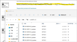

  • Hi Nicholaus_Malone,
    Two questions.
    1. I got a EEPROM image from Scott. Is this a EEPROM pre-loaded image before SMT ? Which means I can use this image(hex file) to program EEPROM through a EEPROM programming socket before SMT ?
    2. It seems that I need to configure DS160PT801 through SigCon Architect. But I don’t find any DS160PT801 profile or updater. Where can I get the          DS160PT801 updater ?
    Thanks.
  • Hi Wen-Hsin Wang,
    The DS160PT801 SigCon Architect profile and SigCon Architect framework is not in SIGCONARCHITECT-RETIMER-PROFILES.  It is available in a different MySecure folder.  Please send me your e-mail through direct message and I will grant access.
    Nicholaus

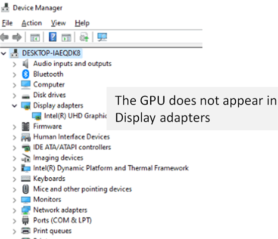

  • Hi Nicholaus,
    1. The PCB is back but it can't work. We have checked power, CLKREQ# and PERST#. All of these signal seems good. Do you have any recommendation for further debug ? Which retimer's register can we read to check retimer's condition ?
    2. The EEPROM FW I use is DS160PT801.hex. Is that OK for my topology ?
  • Hi Scott,
    1. Did they make the changes I recommended to the board they built?  If so, would you mind taking a screenshot of the high-level page of SigCon Architect so we can see the retimer status?  What does "can't work" mean?  Does the system not achieve a PCIe Gen1 link?
    2. This EEPROM should be OK.  The link width for this application is 1x8 correct?
    Nicholaus
  • Hi Nicholaus,
    1. "Can't work" means the GPU does not appear in device manager when system power up.
    2. We will try to modify PCIE speed configuration from BIOS to see if system can achieve PCIE GEN1 or not.
    2. Yes. 1x8.

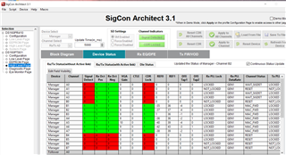

  • Hi Nicholaus,

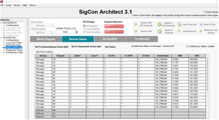

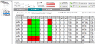

    1. The high level page screenshot. Looks like some channel loss signal ?
    2. The cable length is approximately 16 inch.
    high level.zip
  • Hi Wen-Hsin Wang,
    If channel loss was an issue, I would expect this to fail at PCIe Gen4 or Gen3 speeds, but it should downgrade to a Gen1 link.
    The high-level page shows that Channel B2 is not detecting a signal.  I recommend investigating channel B2 and ensure the signal is successfully reaching the DS160PT801.
    Nicholaus

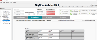

    We adjust the "Bifurcation options" from 1x16 to 1x8 and the system reach the DS160PT801 successfully. The Nvidia graphic driver also appears in device manager. But I have no idea why the Bifurcation options shows that the system is 1x16.

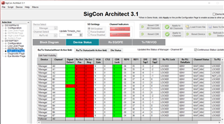

  • Hi Nicholaus,

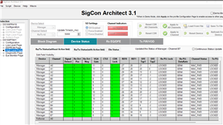

    We adjust the "Bifurcation options" from 1x16 to 1x8 and click Initialize button. After restarting the system, it reach the DS160PT801 successfully. The Nvidia graphic driver also appears in device manager.
    But I have no idea why the Bifurcation options shows that the system is 1x16. Are there any registers we can read from the Low Level Page or EEPROM Page to see if the link-width setting is correct or not ?
    Besides, I capture some images from the system which can successfully achieve PCIE GEN4 link. We have some questions.
    1. What does VGA Gain mean? Is VGA Gain the same as pre-emphasis ?
    2. According to the images, are the PCIE signals good ? Do we need to modify any settings to improve PCIE signal quality ?
    Thanks.
  • Hi Wen-Hsin Wang,
    After the system is restarted it is likely that the registers were reset and the link-width setting "1x8" was changed back to "1x16".   If the link was successfully established, it suggests there is no issue.  I'm unsure why it started working when you performed this change.
    Yes, you may look at the Configuration Guide on MySecure for the register map.  It will show you that 0xF2 and 0xF3 are the link-width registers.
    1. VGA Gain is a variable gain amplifier that is present at the Rx of the retimer, it is automatically adapted to the best setting and shouldn't be changed.  It is not the same as pre-emphases, which is a Tx signal conditioning technique.
    2. It looks good, but it would be better to perform PCIe system testing to ensure the signal quality is good.  The retimer can only show what the signal quality lookes like in the retimer, not what it looks like on the far-end near the root complex or endpoint.  The retimer automatically adapts all of its signal conditioning settings to the best value, so its settings do not need to be modified like a redriver.
    One more thing, it looks like they are using SigCon Architect 3.1.  The version in the MySecure folder is SigCon Architect 3.2.  I recommend the customer update to the latest version.
    Nicholaus

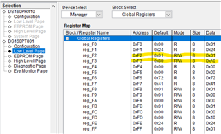

    1. I capture the images about 0xF2 and 0xF3 register data while system power up. Looks like it is a x16 link-width. But it's weird. The EEPROM_Readme file says that the link-width is determined by the 'WIDTH' pin setting and our 'WIDTH' pin is floating, so it's supposed to be a x8 link-width. Not sure why it becomes a x16 link.
    How does retimer determine the link-width ? Does the link-width not only determined by the WIDTH pin ?
    2. Can we modify the EEPROM data to force the link-width to 1x8 through Sigcon Architect?
  • 1. You are correct, if you use the DS160PT801.hex file, which does not load a link-width setting into the 0xF2 or 0xF3 registers, the link-width setting should be whatever the pin-strap setting is.  According to the datasheet, a floating link-width pin is not 1x8.  It is the register default setting, which is 1x16.  Do you have the latest datasheet?
    If the width pin is floating, the link-width setting is determined in order by:
    1. The default register setting in 0xF2 and 0xF3, which should be 1x16.
    2. The current register setting, whether it is loaded by EEPROM or manually changed through I2C.
    There are two ways you can force the link-width to 1x8 when the link-width pin is floating:
    1. Set the 0xF2 and 0xF3 registers to 1x8 in the EEPROM image.
    2. Write to the 0xF2 and 0xF3 register a link-width of 1x8 before PCIe link training begins.
    You can also force the link-width to 1x8 by changing the pin-strap setting to level-3 (10K to PWR_1)
    Nicholaus

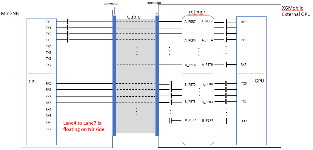

  • Hi Nicholaus,
    Another issue.
    So far the x8 model is normal. But it is abnormal when using the same external GPU device connect to a x4 notebook. The symptom is the same as before. The GPU does not appear in the device manager.
    The topology is shown below.
    My question is:
    1. Does retimer support 1x4 ? According to the datasheet, I only can see it support 2x4.
    2. I have tried to modify the "Bifurcation Option" to 1x4 and 2x4 from Sigcon Architect but still can't fix this issue.
    3. I have tried to modify the strap pin setting to level-1 but still can't fix this issue.
    4. According to the topology. Which link-width setting should I set ? 1x4 or 2x4 ?

    The external GPU appears in device manager while in x8 mode with x4 notebook. Looks like the problem is solved by changing retimer to 1x8 mode.
    But the GEN speed is only PCIE GEN1. Not sure what's going on because the GEN speed can reach to PCIE GEN3 in x8 mode with x8 notebook.
    I capture some images from Sigcon Architect. Can you please help to check ?
    Thanls.
    1581.x4 notebook.zip
  • Hi Wen-Hsin Wang,
    It appears that channel B0 does not see a signal in this configuration, but from your block diagram it should be routed from GPU to the retimer. Please ensure that this channel is connected appropriately.
    David

    I have reported the routing issue to my director and I am still working on how to modify it.
    Besides, there is another question. Even though the routing is wrong, the link is still established successfully but it is in "compliance mode".
    Why does the link can enter the "compliance mode" if I set the "Bifurcation options" to 1x8 but fail if I set to 1x4 ?
  • Hi Wen-Hsin,
    I believe the link is able to enter Gen1 compliance mode due to the detected RX terminations on four lanes A/B4-7. If I remember correctly (based on this image below), all channels A4-A7 and B4-B7 are terminated, while channels A0-A3 are unterminated. To my knowledge in x4 mode, the retimer is looking for termination and signal on lanes 0-3, not lanes 4-7. So, in x8 mode, the retimer detects 4 lanes of active traffic on lanes 4-7 and begins transmitting a compliance pattern on those lanes, while leaving lanes 0-3 idle.
