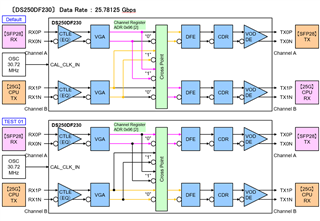

Our customer has asked us about a DS250DF230 with unstable CDR locks.
The block diagram in the upper part of the image (Default) is the configuration used in the operation.
The Cross Point of DS250DF230 is enabled and routed below.
 CPU(LX2160A) --> DS250DF230 --> SFP28
 SFP28 --> DS250DF230 --> CPU(LX2160A)
The block diagram in the bottom row (TEST 01) is the configuration looped back for verification.
 The Cross Point of DS250DF230 is not switched, so the route is as follows.
 CPU(LX2160A) --> DS250DF230 --> CPU(LX2160A)
 SFP28 --> DS250DF230 --> SFP28
In the two configurations, the CDR lock of the input signal (RX1) from CPU(LX2160A) is not stable, so the configuration in TEST 01 in the bottom row is verified.

    Am I correct in assuming that CDR lock on RX1 is not stable regardless of crosspoint configuration?
    About how much insertion loss is between the CPU and RX1?  Is any chance of over equalization?  What is the VOD of the signal sent by the CPU?
    Drew

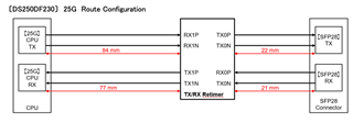

    About how much insertion loss is between the CPU and RX1? ⇒ About -4db at 12.5Ghz.
     Is any chance of over equalization? ⇒ Maybe there is a possibility.
    What is the VOD of the signal sent by the CPU? ⇒ About 300mV.
    With additional information,
    The substrate material is Megtron 6. And the wire length is as shown in the figure.
    Thanks for providing an update.  I have a couple of experiments to try and see how this impacts CDR lock stability.
    1) Is it possible to increase CPU VOD?  This seems a bit on the low side.  I would be curious to know if a CPU VOD somewhere in the 600 mVpp - 1000 mVpp range improves CDR lock stability.
    2) Enable adapt mode 2 and DFE.  This allows the device to adapt both CTLE and DFE.  DFE can help improve the signal eye.
    3) In the event that the CPU signal is being over-equalized, there are a couple of things we can try to address this.  One is to enable CTLE boost override and manually set CTLE.  From the screenshots you sent, it appears CTLE was 3.  I would try working down from 3 to see if the eye improves.  The DS250DF230 also has a CTLE bypass, which bypasses 3 of the 4 CTLE boost stages.  This can be enabled by setting ch_reg_0x2D[3:2]. = 2'b11.  Please see programming guide for additional details.
    Please try these experiments and observe CDR lock stability and retimer HEO/VEO for each.  I think the results of these experiments will help us identify the root cause of CDR lock instability.

    I received a response to my proposal and an additional question from a customer.
    They are listed below.
    [Question + Answer.
    (1)>Earlier you had mentioned that in addition to a typical configuration of CPU --> SFP, SFP --> CPU, it is possible to test SFP --> SFP and CPU --> CPU.
        >Can you clarify in which configurations you're observing link instability?
    (1-answer)
    ⇒ In the CPU → Retimer → SFP and SFP → Retimer → CPU configurations.
      Since the link was not working in both directions, we did not enable the crosspoints (in a configuration that is easy to verify)
      CPU → Retimer → CPU, SFP → Retimer → SFP configuration.
      In this case, the following conditions were achieved
      In the direction of SFP → Retimer, CDR Lock is stable and the link is up.
      In the direction of CPU → Retimer, CDR Lock is unstable and Link Up is not performed.

    (6- Additional confirmation request)
    Since the Link state was stable in the previous verification, the following verification was performed.
    The following verification was performed.
    > CDR Bypass, Pre-LOCK = Raw Data, Post-LOCK = Raw Data
    > Link state was stable when both Pre and Post were set to Raw Data.
      See the attached "TEST_memo20230315" for the test summary.
      CPU → Retimer → SFP28 (CH-0)
      SFP28 → Retimer → CPU (CH-1)
      The only difference in settings between the two configurations is in the following parts.
      CH-0
      CH-1
       CDR Bypass, Pre-LOCK = Mute, Post-LOCK = Retimed data
      Since CH-0, CPU → Retimer is set to CDR Bypass, Raw Data, CDR Lock is unstable, but the link partner is in Link Up state.
      CH-1, SFP28 → Retimer is in the Link Up state with CDR Lock in the same stable state as before.
      With this setting, communication is possible.
      CPU <--> Retimer <--> SFP28 <--> 25G Transceiver <--> optical communication <--> PC (25G)
    Looking at the verification results so far, it seems that the CDR Lock instability is caused by a pattern, not a signal level.

       Execution script
       . /sfp28_retimer_status.sh 120 0 2 (SFP28 #0 port)
       . /sfp28_retimer_status.sh 120 1 2 (SFP28 #1 port)
      Output direction (CH 0)
       CPU --> Retimer
        Monitor SD/CDR Status, HEO, VEO of Retimer
       Retimer --> SFP28
        SFP28 side monitors CDR Lock status in 25G Transceiver
      Input direction (CH 1)
       SFP28 --> Retimer
       Retimer --> CPU
        CPU side monitors MAC (PCS) layer Link status

    Is it possible to check the behavior of the retimer by sending only the PRBS pattern from the CPU?
    (Answer)
    ⇒ The verification environment is the same as the following test we have been doing.
      CPU --> Retimer --> Retimer
      SFP28 --> Retimer --> SFP28
      Link training and auto-negotiation are disabled.
      No FEC
      Observe CDR lock status of CPU --> Retimer
       test_01-03
       test 01V - 03V (with eq_vga = 11)
      In this test, only 7 PRBS patterns were sent from CPU.

    Do they have any channel models and models for their CPU TX?  Perhaps we could try an IBIS-AMI simulation to see if it helps us understand the issue if measurements are not possible.
    Also, as another question, what do you think about the fact that the CDR with a built-in 25G transceiver is locked when the inside of Retimer is bypassed?

    Regarding the previous question "Do they have any channel models and models for their CPU TX?" the customer ran the simulation and changed the CTLE and DFE values and the EYE pattern improved The customer reported that the EYE pattern improved after changing the CTLE and DFE values.
    As an addendum, he said that the substrate material is megtron6 and that the signal lines are inner-layered.
