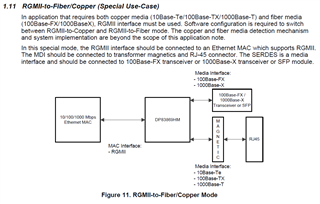

    i think if i select RGMII to Fiber/copper ( special use case ) mode Mention in 1.11 section of snla318 document then i can acchive my above requirement but i am not sure please share your thought .
    https://www.ti.com/lit/an/snla318/snla318.pdf?ts=1673422108457&ref_url=https%253A%252F%252Fwww.google.com%252F

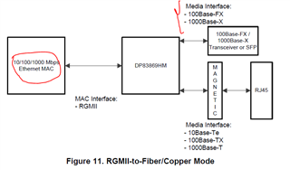

    Let's discuss what i need
    - i need converter that can communicate with network switch over SFP .
    - so connection shoud be like below image
    Requirement setup
    I know that it will alwase work if i have both side same setup with EVM .

  • Hi Nikunj,
    Thank you for your detailed response, I believe I have a better understanding of your application now.

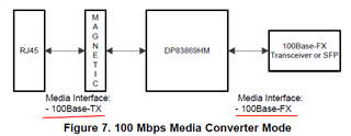

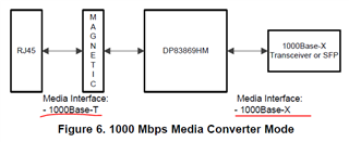

    Media Converter mode:
    As you mentioned this cannot be a solution for your application, as the speed should be same on both ends that is Copper side and Fiber side.
    Your application topology as just a converter:
    If my understanding is correct, the above setup should help with your converter application to connect to a network switch.
    Please let me know if you have further queries.

    1) regarding the below image as Media Converter mode
    Can you please suggest me if this type of configuration available in TI with some App note Or Design guide.

    PC (10/100/1000) <-> (869 1000M media converter) <-> Gigabit SFP Module <-> Optical Cable <-> Gigabit SFP Module <-> Network Switch (10/100/1000)
    PC (100M forced) <-> (869 1000M media converter) <-> Gigabit SFP Module <-> Optical Cable <-> Gigabit SFP Module <-> Network Switch (10/100/1000)
