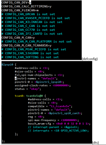

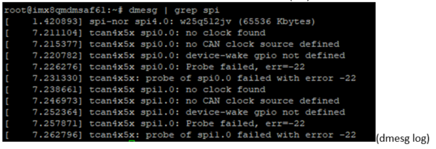

  • Hi Eric,
    The customer had some progress but is still having issue. Here are some screenshots. (I'm sorry but I don't really know what's going in these screenshots)
    I will ask the customer to post their questions here directly from now on so that you can better understand their questions. Thanks for the support!
    Roy

  • Hi Eric, I have some probelm
    1. Does the tcan4x5x driver in linux kernel version 5.4.70 supports multiple tcan4550 device in multiple spi bus ?
    2. Is there a lot difference of the optional GPIO setting between the tcan4x5x driver of the linux kernel version 5.4.70 and the linux kernel version 5.15.52 ?
  • Tony,
    1. No, I don't believe the linux driver supports controlling multiple TCAN4550-Q1 devices.
    2. Can you be more specific? What do you mean by differences between GPIO settings? All configurations for GPIO should be available in all versions of the driver.
    Eric Hackett
  • Hi Eric,
    we're now facing an issue about linux tcan4x5x driver probed error in the linux kernel version 5.4.70.
    In the device tree, we set up 2 tcan4x5x device, using same gpio as can_rst pin.
    lpspi0 {
      tcan4x5x@0 { # first device
        reset-gpios = <A>;
    lpspi1 {
      tcan4x5x@0 { # second device
        // reset-gpios =<A>;
    I have changed wake gpio into optional, by comment the return -EINVAL
    After this change, the first device can successfully be initialized, but the second device
    1. add same reset gpio, driver probed failed with duplicate pin definition error.
    2. comment the reset gpio, driver probed failed with null pointer error
    But tcan4x5x driver in linux kernel version 5.15.52, using the same device tree setting(comment the reset gpio of device 2), without set up any device wake gpio, device state gpio and reset gpio, it works fine.
    BR,
    Tony
