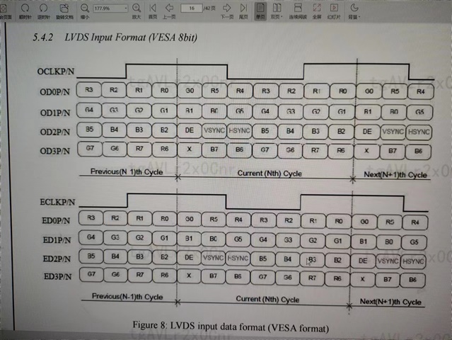

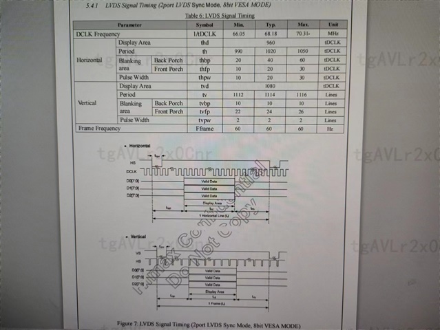

    Can you please send over the datasheet for the display panel here?
    Casey
    I don't see any obvious reason why the colors could be changed other than the clock polarity. Have you tried enabling the different MAPSEL settings in the 948? Based on your panel spec you should be using MAPSEL = H, but you could also try MAPSEL = L?

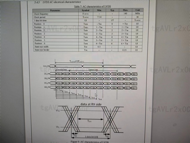

    948 will not be able to directly generate the exact timing for this panel which may be part of the issue. The maximum PCLK that 948 can generate is ~140MHz (70MHz per channel) but the exact PCLK rate is not well controlled (very high variation unit to unit). Can you measure the PCLK rate that you are getting from the 948?

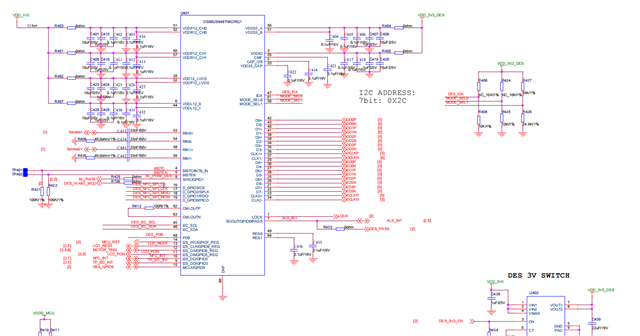

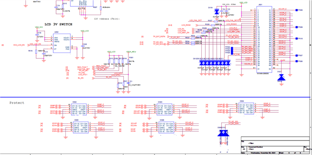

    In the meantime can you also please share your schematic for this system for review? Including the 948 and the LVDS panel connections from 948 to the LCD?

    The video timings for the PATGEN script need some adjustment to match the panel's datasheet. In the panel spec, back porch includes the sync pulse widths for horizontal and vertical, but for the 94x, they are not combined. So based on the spec above,
    HBP = HBP - HSW = 40 pixels
    VBP = VBP - VSW = 8 lines
    Also I am not sure why you are enabling color inversion in register 0x65[1]. I would suggest to set 0x65 = 0x04
    So your script needs the following adjustments:
    //a:1920*1080   total:2040*1114  hbp:40  hfp:40  hpw:20  vbp:8  vfp:24  vpw:2  vs_hs_pol:Negative
    uint8_t reg_data[] = {0x03, 0x02, 0x07, 0x80, 0x08, 0x87, 0x09, 0x43, 0x04, 0xF8, 0x05, 0xA7, 0x06, 0x45, 0x0C, 0x28, 0x0D, 0x08, 0x0A, 0x14, 0x0B, 0x02, 0x0E, 0x03, 0x04, 0x31};
    Can you give that a try?

  • Hi Casey,
    We have solved this problem. The RL pin of the screen, which controls the display content flipping, should be set to H. We infer that this pin affects the internal timing of this screen.
    Thanks a lot!
