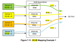

hi,
customer use VC-ID, the picture is as below:
if one of the camera is unplugged, can 960 identify which camera is disconnected? is there an indicator to see?
thank you

Hello Yuan,
Yes, you would use the LOCK status in register 0x4D which is RX port-specific. Select the RX port with 0x4C, and then read the port's LOCK status using 0x4D to determine which lost lock. You could also map 4 different GPIOs to provide the LOCK status of the 4 RX ports independently, and then use 4 signals to the SoC to be able to immediately determine which lost lock without needing to poll registers
