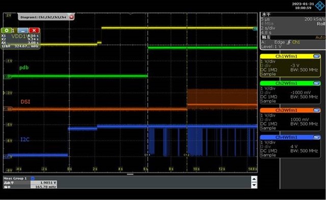

Dear expert,
Customer already mass production for over 100Ku UB941 with no problem.
Now they met random unlock issue with 3 pcs UB941 with UB948.
UB941 use external 133M clock and shows problem.
The problem is gone if using DSI clock or internal clock.
It seems problem comes from external clock.
But ABA swap experiments is done. the phenomenon goes with UB941 silicon.
External clock is very stable with scope measurement.
Customer doubt the problem comes from UB941 internal circuit after external clock come in. Do you have any comment on this?
