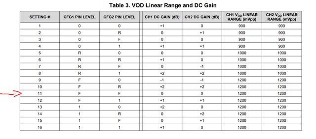

The CPU to re-driver(TUSB1002ARGER) distance about 8 inch in current design and could you suggestion VOD Linear Range and DC Gain setting ?which is batter it's use on USB3.2 .

It depends on the input signal. The gain of the incoming VID should be kept to less than or equal to the TUSB1002A VOD linear range setting so the TUSB1002A output signal almost has the one-to-one ratio to the input signal.
You can use CFG0/1 = "F, F" as the starting setting,
