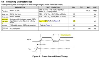

Hi Expert,
We can see the RSTN minimum width spec and power on / Reset timing on TUSB212, show as below, but can't to see in TUSB211.
so could you help to share same criterial of RSTN for TUSB211 to me? does it same with TUSB212?
