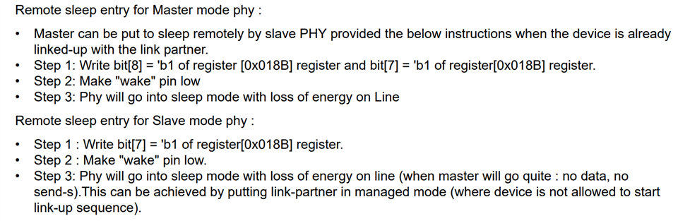

  • Hi Ahmed,
    For remote sleep entry, step-1,2 should be programmed on the DUT after the link-up.
    Whenever link partner wants to put the DUT in sleep, link partner should immediately stop transmitting. The DUT will then go to sleep.
    Gokul.

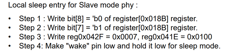

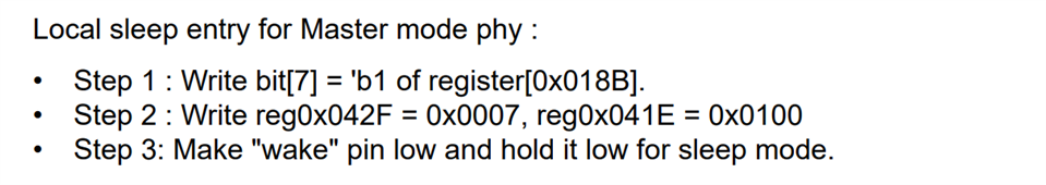

  • Hi Ahmed,
    Sorry for the confusion I have caused.
    Initialization Settings after link-up: Program both devices to support remote sleep for master and slave as shown below (Steps-1,2)
    This is how you can switch from remote sleep to local after the above initialization.
    If you want to switch Master to Local sleep:
    1. Make Wake low to high on Master
    2. After toggling Wake, program 0x018B[8] = 0 for Master PHY
    3. Follow Steps-1,2,3 as shown below
    4. After this, Master goes to sleep.
    5. Slave also eventually goes to sleep as we have enabled Remote Sleep entry already.
    Instead if you want to switch Slave to Local sleep:
    1. Make Wake low to high on Slave.
    2. Follow Steps-1,2,3 as shown below
    3. After this, Slave goes to sleep.
    4. Master also eventually goes to sleep as we have enabled Remote Sleep entry already.
    Please let me know if you need more details.
    Gokul.

  • Hi Ahmed,
    0x018B[8] should be 1 for remote sleep on both master and slave. It should be 0 on both master and slave for remote sleep.
    Gokul.
