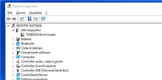

I'v been ask to post my concern here by customer support. The problem I noticed is that the flash burner installer does not install the tusb9260 bootloader driver under windows 10 pro 64 bit os.
After several trial I unzipped the original Flash burner installer version 2.10.0 and tried to install the driver manually. The os failed to install because it does not recognize the inf file as a valid one.
In the weekend I spent some time reading Microsoft documentation on the inf file and notice that some sections that Microsoft marked as required are not present in the inf file. Readering Microsoft documentation it seems that sections like DefaultInstall and DefaultInstall.Services are required.
Could you please help me? Could you please test how to install the flash burner and specially the driver under windows 10 pro 64bit os?
My developing project is stalled because I deleted the boot loader on the demo board and I cannot flash any firmware on it.
