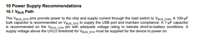

Could you advise the minimum capactiance required for Bypass capacitor connected on VBUS_SYS pin?
I only use upto 500mA or 900mA, I would like to know the minimum requirement for the cap.

Hi Tsuji-san,
Our datasheet recommend is 100uF, but from my side, I guess if you just use the 900mA, one 47uF and one 01uF will be ok, if your VBUS source is near the TPD3S716-Q1, and you just use the 900mA. Thank you.
