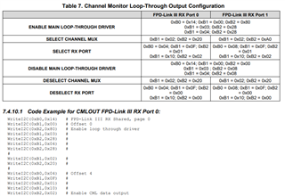

Hi Teams,
Please tell me about the CMLOUT output stop on the DS90UB954.
I am assuming that the CMLOUT output is disabled by default and I need to switch the setting to enabled when I want to measure eye aperture.
Question.
If the register setting is the default, is the CMLOUT output enabled?
I would like to know if there is a register to enable/disable the output of CMLOUT.
(Is ADAPTIVE_EQ_BYPASS at address 0xD4 that register?)
