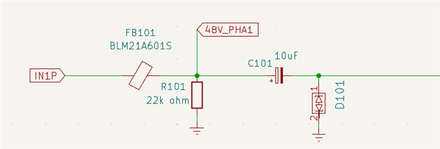

I'm interested in creating a circuit for input into a TLV320ADC6140 ADC. I want to make it as robust as possible. Is it appropriate to put the ESD protection behind the coupling capacitors like this? Will the TPD1E10B09 provide ESD protection to the IC?
I found this schematic from this document https://www.ti.com/lit/an/sboa320a/sboa320a.pdf and then added the TPD1E10B9.is that right? Is R2 Necessary?
Thank you for your help.
Jay
